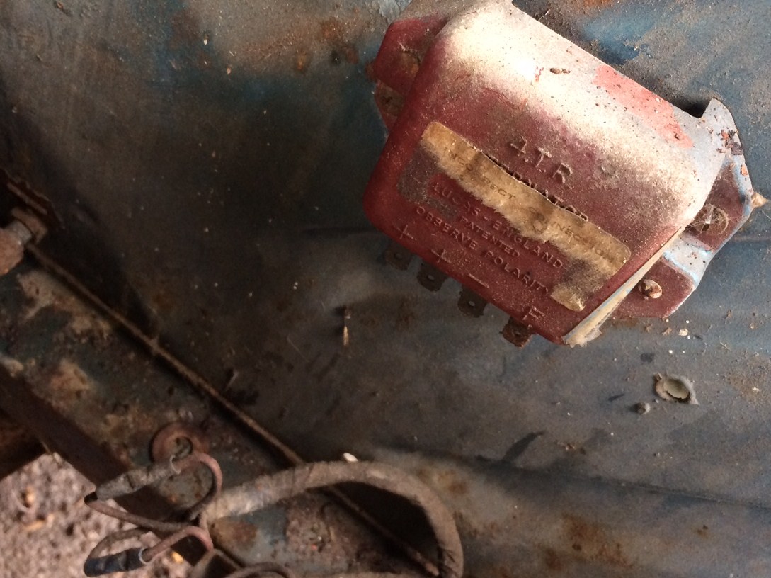

Hi Guys,
Just wondering if anyone can tell me what this electrical part is in the engine bay was for as it has no wires going to it, I didn't have one on my earlier Fastback, I wondered if it was for the original alternator?
Thanks in advance
devnet H120 |

I think it may be an external regulator pack for the alternator Later alternators don't use them as they are "built in"

| I think these were only fitted to the very early cars, perhaps if yours is a later car someone has retro fitted it to get over an issue. I think Mark Reader and Martin Bowden have them on their early cars, might be worth asking them or simply converting back to the later type that Andy B mentioned with the internal regulator. |

Yes, a 4TR, rectifier or regulator pack for when the early cars had a 16AC Alternator fitted. Later cars with the 16ACR Alternator did indeed have the regulator 'built in'. Most cars would be running 16ACR's now and so these are largely redundant. I think some purists like to keep originality, so you can still get them, but taking them out of the circuit is easy, so I personally would not bother with them. Cheers. G. |
