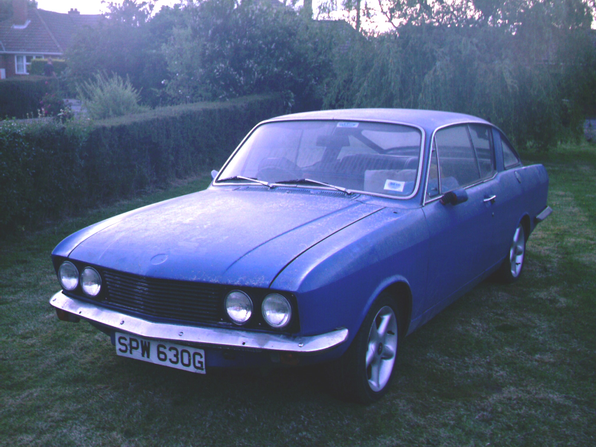

Here's my Rapier. Bought it in 1986 and had it ever since apart from three or four years while a good friend of mine owned it (but that's another story).
Under bonnet is an 1840 Holbay Marathon guesstimated at 130bhp. It has lowered suspension (one inch) with spax shocks all round, wheels are 7x15 TSW alloys with 195x50x50 tyres. Pretty much every mechanical part has been replaced during the 17 or so years that I drove it as my every day car.
At the SROC National (possibly 2001):
At home - around 2002 (I think):
Again in 2006 - not looking so good now. Mechanically perfect but suffering rust in sills and front panel.

The blue one is now orange.
It is very nearly back on the road, just a few more jobs to do. I stripped it back to bare shell and built it up again.
1922 Coltec/Swaymar engine.
I200 6 speed gearbox
3 litre Capri back axle
4 pot calipers and vented disks at the front (thanks Paul Marshall)
Avenger rack and pinion connected to BMW5 series column
