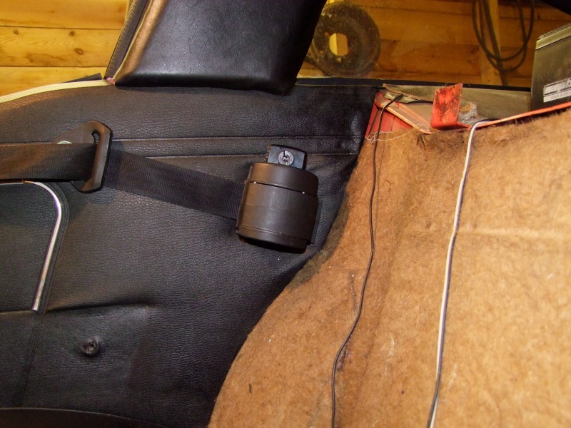

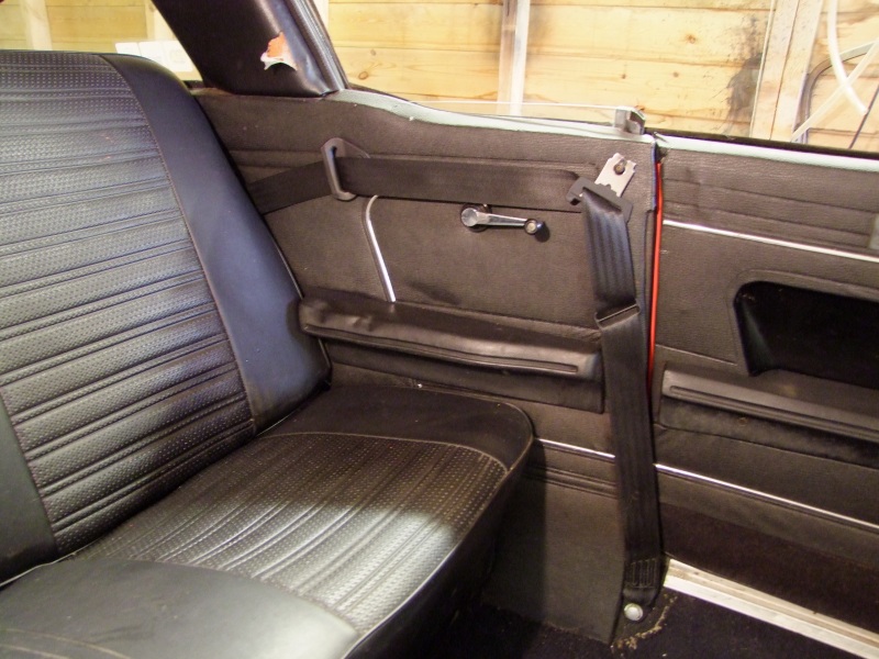

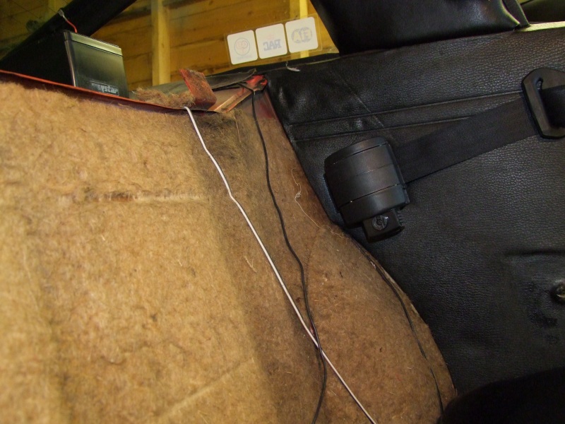

I have got some pictures of the belts fitted to my '73. I found a '74 in the breaker's yard and measured where the mounts should go - I used it's belts for a few years before replacing them with the Securon belts.
Here is a couple of pics showing the retractor units:
Here is how they look with the seat back fitted:
This is all that you can see of the retractor - the side of the seat back has a recess for it (this seat is from a '75 car)
And finally the other end - these are fabric because these belts are sold for use in the rear.
I have (or had) a cardboard template to get the mount hole in the correct place for the retractor unit. I drilled a hole and put a proper seatbelt mount plate behind it - and plug welded it to the back of panel through four small holes.
