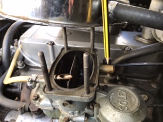

Hi, On the carb top body, on the opposite side to the fuel inlet there’s a biggish brassy pipe, which is part of the carb, is there something that goes on it? I still have the big pan like filter with a pipe out the back above the carb and this pipe which is connected to the breather on the oil fill tube. Could this be why it’s running very rich??

Send us a photo of this brass pipe and perhaps we are able to help you out on this one.
It it certainly possible that breathing system is clogging the air filter with oil and that causes the engine to run rich, but there are more posssible causes for running rich and in order to detect the culprit you have to investigate methodically, so start with checking the ignition system before you start on the fuel system.
Better is to use both a vacuum gauge and a color tune in order to find out what causes the rich running.

Hi Peter, this is the pipe taken from the left side of the car, phone above the wiper motor.
If I successfully load the pictures I have pointed to the pipe with a pencil, it goes directly into the choke chamber. There must be a connection of some sort on there!

Coincidentally I just returned from my garage in which I have a Solex carburettor laying aroud which was originally fitted at my Rapier series IV and.....I did not see such a pipe on this carburettor which is still fitted on the original inlet manifold. The Solex carbuettors on both the series IV an V are in principal the same but the top covers are different as can be seen in the Rootes Parts list. I can see the pipe you are refering to in the parts list.
A further investigation learns that the pipe you are mentioning is the pipe on which the hose from the flame trap to the carburettor is connected. So the engine breathing is not going from the valve cover via the flame trap to the air filter but directly to the carburettor while on my series IV the breathing is organized a little different.
Your Solex carburettor is in detail described in WSM 145 (light car range with 1725 cc engine). In the engine section (section B) on pages 33 and 44 the engine breathing system is described while in the Fuel section (section C) the carburettor is explained on pages 23 up to 44.
By the way if the existing pipe (on which is now no hose fitted) is not blocked off than adjusting the carburettor will not be easy, so I wonder if your carburettor is adjusted as it should. Buy WSM 145 and read how to adjust this carburettor as it should be done. And....this carburettors never had a good reputation only for using a lot of petrol!
