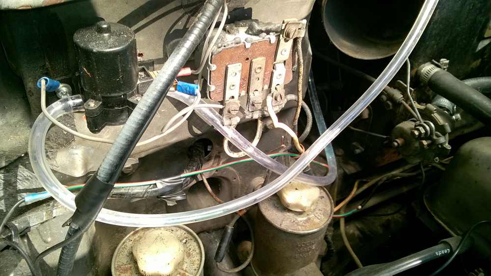

HI can anyone help ?
I am sorting out the wiring on 845 BWN as fitting electronic ignition and there are lots of "spare" old wires hanging about in engine bay.
My mystery is a small metal box directly over the master cylinders, on the opposite side to the control box and fuse box, see picture attached) just what is it , no noise from it so presumably not an old flasher unit ?
Any advice appreciated
thanks Royston

Has your Rapier an overdrive? If so it could be a kind of overdrive relay, not the original one but one that is "repaired" or specially fixed. So my advise is: follow the wires and make a drawning were they go to. If you report back on this forum with a drawning then somebody will react. If I understand the drawnimg of the wires I will certainly react!

Excellent , now you have got me started on the idea, I have tested the overdrive switch and yes, it clicks inside my mystery box ! It IS the overdrive relay , thanks a lot for quick reply.

Your Rapier is original equipped with a Lucas Relay type SB40 with number 33157 and is a non self canceling relay. The Rapiers series 4 and 5 have a Lucas Relay type 6RA with number 33199 E stamped on it.
The last one is the preferable one!
It is possible that your existing relay has been transformed to a self canceling relay hence the changes to the relay. So what I would do is the following: check if your existing relay is self canceling. If it is and all is working fine don't touch it: if it works it works.
The relay which you mention that is on Ebay should be checked for if it is the right one. See above for the right numbers. The majority of the relays that are offered on Ebay don't suit our Rapiers in spite of what the vendor is telling you.
