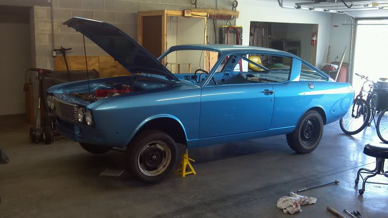

My father is restoring a 69 Alpine GT. The car was sitting in a field when he bought it and it only had 22k miles on it. But he completely dis-assembled and is now getting it back together. He is having one problem. The GT cam was bad so he discarded because he had a parts car. He used the cam from it, but after spending months trying to get it to run we discovered there is a GT cam and a non-GT cam. His engine is a 1725 aluminum head GT engine and the cam that is in it is a non-gt cam...our problem. But we cannot find a cam anywhere. Sunbeam Specialities said they are not available anymore. Any ideas where we can find one?

The Alpine GT was known as the rapier here in the UK (we know you guys like to change our words ). Anyway, I'm sure there will be someone here that can help you, I do have one but will not be able to get to it for a while. Out of interest, I'm not 100% sure but I'm wondering if the 2 seater Alpine (series V) which also had the 1725cc engine may have the right camshaft? If so you might find one that way as the Alpine (2 seater) is quite popular in the US.
Good luck and nice looking car btw, more details and pictures would be good.

The irony is that if you had asked for a Holbay one, (H120 engine), I could have sorted you out. Looks really nice in the pic, how bad was it when your father started work on it? Finding any with 22,000 miles on the clock is virtually unheard of over here now.
