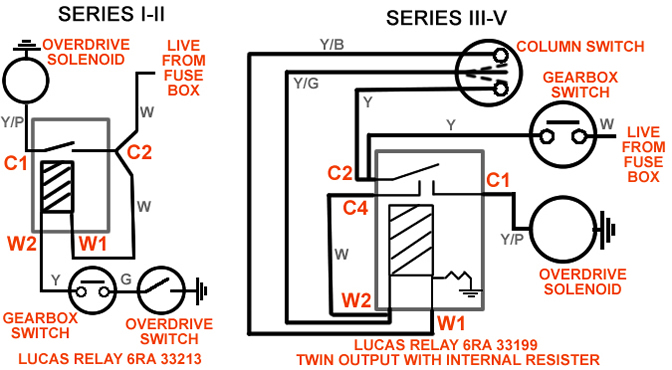

hillman
107 Posts |
Posted - 22 Nov 2020 : 08:15:02
Hi , I don't know if it helps but here are the wiring diagrams.

Thank you, I do have the manuals but it’s all helpful, thank you. I’m starting by sending off for the correct wiring (colours with tracers etc.). Currently it’s wired almost exclusively with overly long purple wire? Do you know how to test the later style relay? I found an explanation for the earlier one, and according to the Multi Meter that one is working correctly, but I can’t find anything similar for the later type. Thanks again. Terry |

Posted - 23 Nov 2020 : 19:47:57
To test later type of unit.
To test the Relay, You need a 12v battery, cables and a multi meter. Earth the body of the unit
Check for discontinuity (NO CONTACT) between terminals C1 and C4 Apply a 12v supply to terminal C2
Then when you add a 12v supply to terminal W2, You should hear a click Check for continuity (CONTACT) between terminals C1 and C4 Remove supply from W2 Check for continuity (CONTACT) between terminals C1 and C4 Then add a 12v supply to terminal W1
You should then hear a click again
Once again Check for discontinuity (NO CONTACT) between terminals C1 and C4
If the relay passes all the above in order it is working correctly.
If at any point it does not, get another relay unit.
They are a sealed unit and can not be fixed.

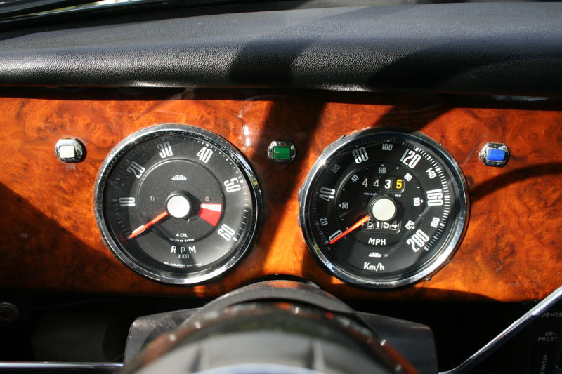

323 Posts |
Posted - 24 Nov 2020 : 11:46:47
Here you see the warning light on the dashbord of my Rapier series IV |
Thanks again Peter, the funny thing is your photo prompted me to think about something else entirely and I was able to undo another bodge (slechte reparatie ((not many of my Dutch colleagues would understand 'bodge' if I said it)) ). By a long chain of thought, having looked at the photo, I realised that my RHD car has the speedo and rev counter mounted incorrectly left/right. I recently changed the speedo cable as the old one was too tight, awkwardly routed and causing the speedo to sit at a slight angle. I figured out that someone had fitted a non overdrive speedo cable, but even with the new cable, better routing and a little slack, the speedo was still being held at a slight angle on its springs inside the bezel. Then I saw your LHD photo, and that got me thinking. So I checked out as many photos of RHD cars as I could find and realised, mine were the wrong way round. Another step forward, thanks. Other peoples knowledge and experience and the Internet, brilliant. |

Regarding the term "bodge" I was fully aware what it means. How could I not when reading magazines like Practical Classics for about 30 years.
So now you know that the overdrive warning lamp is situated at the right upper side of your speedo! Did you already discover the little black plastic plug which covers the hole in the dashbord? If you need more pictures of my Rapier in order to clarify something so just say so and I will provide them.

Ahh yes. My car doesn't have the hole in the dash (being a non overdrive S3 perhaps, not sure?), and I'm far too much of a chicken to drill one. There is a period style switch/warning light bracket attached to the bottom edge of the wooden dash with the screen washer plunger and an empty hole, so I'll use that.
